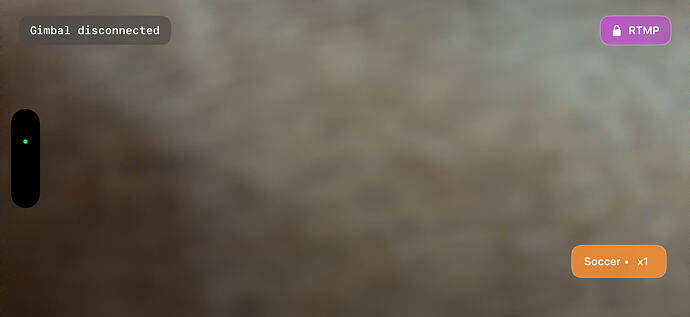

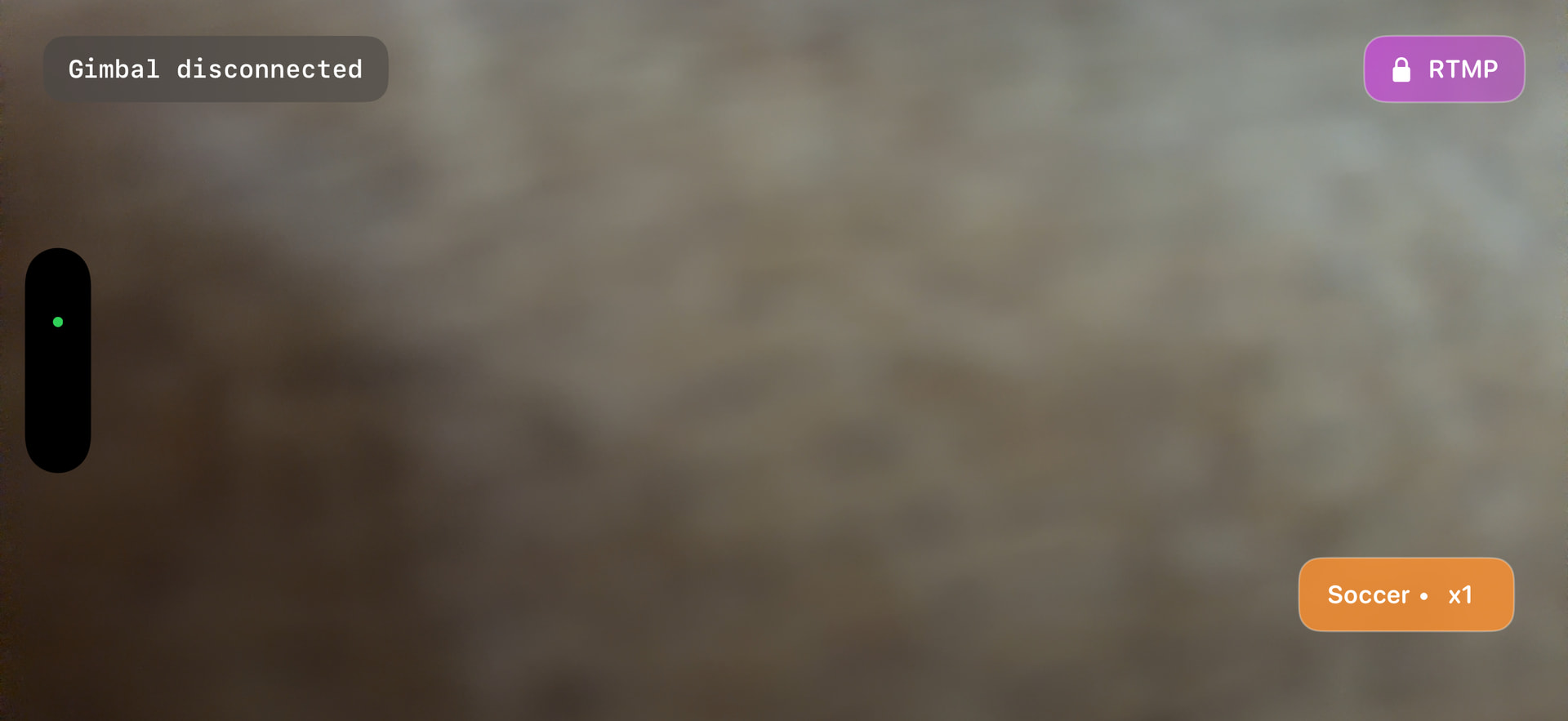

I have an osmo mobile 8p already, but I keep saying “Gimbal Disconnected”. He can’t find the gimbal
Have you completed the NFC pairing? For all DockKit-compatible gimbals, NFC pairing is required for DockKit to work. DJI’s own app may use Bluetooth only, so even if the gimbal appears to be connected via Bluetooth, that isn’t enough for FoloCam to connect.

I used the 8P as well and it seems its not possible to use the remote control and Folocam at the same time. If I activate the screen mirroring to the 8P remote then I get a “Gimbal not ready” error in Folocam. If they can’t both be used simultaneously then the 8P doesn’t make much sense over a cheaper gimbal with DockKit like the Osmo Mobile 8.

I ordered the lifetime subscription with the Comitok gimbal now. I keep having issues connecting to the 8P with Folocam. I have to forget the previous pairing each time then tap the NFC spot a hundred times before it connects and is available for Folocam. I hope the Comitok connection works better but with the 8P screen mirroring incompatible with Folocam the 8P really doesn’t make sense for me.
